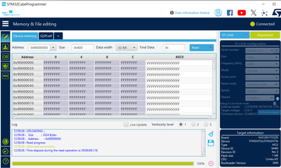

2025-07-23 7:49 PM
Trying to read 0x09000000 not 0x90000000 which is where the QSPI bank is situated.
NINE and 7x ZEROS

hi , thanks now works fine .

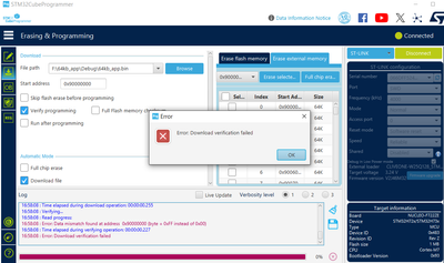

2025-07-25 11:18 AM
My custom external loader stopped working in version 2.18 as well.
I created my own post about it before I found this one. I did hope v2.19 would fix it but it did not. Neither did v2.20.
I use the same Winbond QSPI Flash connected to STM32H743IIK through PB2-PB6-PF8-PF9-PF7-PF6.
My workaround is to stay with v2.17 until a newer Cube Programmer works again.
How did you finally make it work?
Is there a way to report this issue to the development team ?
Or, are there updated requirements for external loader design for new versions of Cube Programmer?

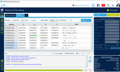

2025-07-26 12:42 AM
My suspect started likewise bellow .
cube mx 6.14.0 will come with cube ide cube ide v1.18.0 (***QSPI problem started***)
cube mx 6.14.1 will come with cube ide cube ide v1.18.1(***QSPI problem Continues***)
cube mx 6.15.0 will come with cube ide cube ide v1.19.0 (*** QSPI completely broken in Cube MX ***)
QSPI problem started from cube v1.18.0 onwards So,I have installed the cube mx 6.13.0 separately and imported further into cube ide v1.19.0 and created elf file tested with following .
QSPI just connect with Programmer via stm32h723zgt6 after QSPI address changes.
i able to write on QSPI Flash (w25q128) visually and it's mapping on proper location.
but nothing was written in flash when i reading Flash memory location .
I am using CLIVEONE stdlr external loader file

Show the download pane and verbose log.
The image shows 0x08000000 and then 0x90000000, so it looks like you wrote to internal flash.

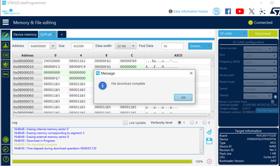

2025-07-26 4:30 AM
whole elf file was downloaded via download menu .

16:54:04:179 : r ap 0 @0x24001EC0 0x00001500 bytes Data 0xFFFFFFFF
16:54:04:180 : Error: Data mismatch found at address 0x90000000 (byte = 0xFF instead of 0x00)
16:54:04:180 : Time elapsed during verifying operation: 00:00:00.223
16:54:04:180 : Error: Download verification failed
i was trying to download some dummy binary file into external memory via down load menu
