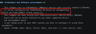

Hi again @Snaku,
I think on CubeH5 we're OK as well since there's a define that needs to be uncommented for 1M flash size in flash_layout.h:
#define DEVICE_1M_FLASH_ENABLE
This is also mentioned in the  OEMiROT_Boot readme:
I've tried the same scenario with the line and without it and it seems to solve the issue. Could you confirm at your end ?
Aziz
Hi Aziz,
When I find this wrong sector issue, my OEMiROT_Boot code already uncommented the line of the flash_layout.h file, I will check my OEMiROT_Boot code, maybe my modification in OEMiROT_Boot cause the STM32CubeProgrammer cannot read the flash size.
Regards,
Snaku
