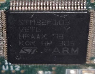

Are you sure that your "STM32F103" is genuine ?

@Andrew Neil wrote:Are you sure that your "STM32F103" is genuine ?
I hope it is:grinning_face_with_sweat:. We've been working with this chip for a long time and this is the first time that this happens.
