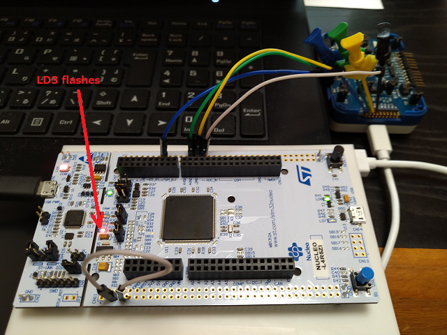

2021-09-12 6:58 PM
Additional information.
I tried it in the CLI and the result was the same.
Attached is an image of the connection between the NUCLEO board and the STLINK-V3SET, and a log file obtained by CLI.
MISO (NUCLEO CN12 pin#28 PB14) is connected to User LD3 (red user LED) of NUCLEO, and LD3 flashes when SPI Connect is attempted.
From this, it seems that STM32 bootloader is responding to the command, but STM32CubeProgrammer is not receiving the response.
Please give me some advice. I'm very confused.
2021-09-12 7:34 PM
Why do you want to talk to the bootloader over SPI? Surely there are easier ways of programming the chip.
You'll need to ensure the device is in bootloader mode and that no other supported bootloader interfaces are active at the same time.
I'm not familiar with the SPI features of the STLINK-V3SET.
