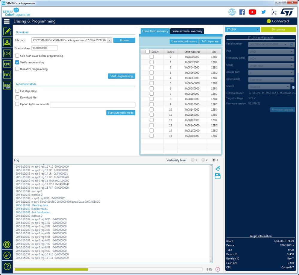

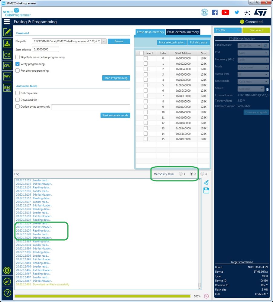

Here trying to understand interactions with an External Loader in STM32 Cube Programmer.
I'm fine with one line of information, but put some actual information in that line, ie for a Read the Address and Size would be a MINIMUM.
I'd use Level 3, but the method used for the Logging Window CHOKES when doing a million SMALL reads on a 32MB SPI device when verifying. What controls the size, the H7 has loads of RAM it uses on Writes?

2021-01-16 7:05 PM
Here grinding along in Level 3, trying to verify an 8MB image 1KB at a time, getting exponentially slower, like the logging method uses a bubble-sort or some continuous malloc/copy to a bigger and bigger buffer to add lines. Window is entirely unresponsive to user interaction, ie scroll, move.
