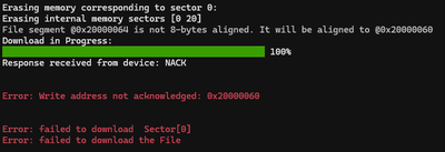

I can flash an HEX file via the CLI but not the ELF one.
More specifically, the flashing seems to succeed (if I reboot the board it works well), it's just at the end that an error message is displayed that I can't understand:
STM32_Programmer_CLI.exe -c port=COM4 br=115200 -d firmware.elf -g
File segment @0x20000064 is not 8-bytes aligned. It will be aligned to @0x20000060
Response received from device: NACK
Error: Write address not acknowledged: 0x20000060
Error: failed to download Sector[0]
Error: failed to download the File

2025-04-09 9:29 AM
RAM is not FLASH
You should double check what's getting into RAM. Review .ELF with objdump or fromelf type dumping tools.
Might be that STM32 Cube Programmer is ignoring NOLOAD / NOBITS type flagging on the sections being exported.
If it's a bug you could report that, or in the mean time you could interstage through a .HEX if that's working
You could use ALIGN(8) if that's what its complaining about, I don't think RAM cares, but the FLASH lines internally might.

2025-04-10 9:20 AM
Thanks for your help. I have managed to fix the issue by indeed adjusting the alignment of the .data section size.
I changed the latest ALIGN to 8 in this section:

2025-04-10 7:04 PM - edited 2025-04-10 7:10 PM
The offending address was 20000064 and in "working" variant changed to something aligned on 8. From your section listings, it is something located between .data and .bss (which has not changed their addresses). But the listings do not show anything between .data and .bss. So it looks to me like a bug in CubeProgrammer, it passes to the target weird bits of the ELF that should be discarded.
