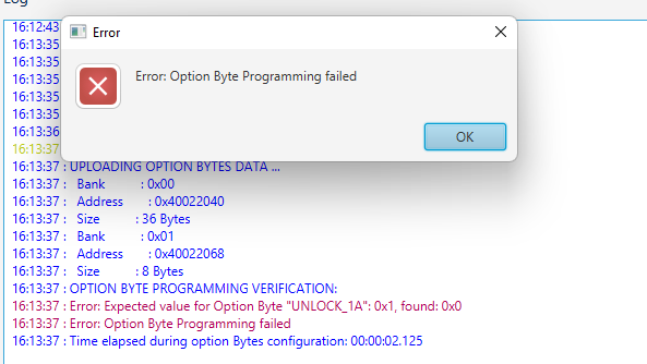

I have a NUCELO-U575ZI-Q that I've carried out the following steps on:
I've also tried using the CLI and can't get any different results, am I missing a step to be able to reprogram the option bytes?
Thanks in advance for your help!

Possible solution:
If I raise the RDP level to DC. Then disconnect/reconnect. Then select AA on RDP, and CHECK UNLOCK_1A - the option bytes successfully program.
For some reason, both things have to happen at the same time (RDP regression, and the UNLOCK_1A byte being programmed)
