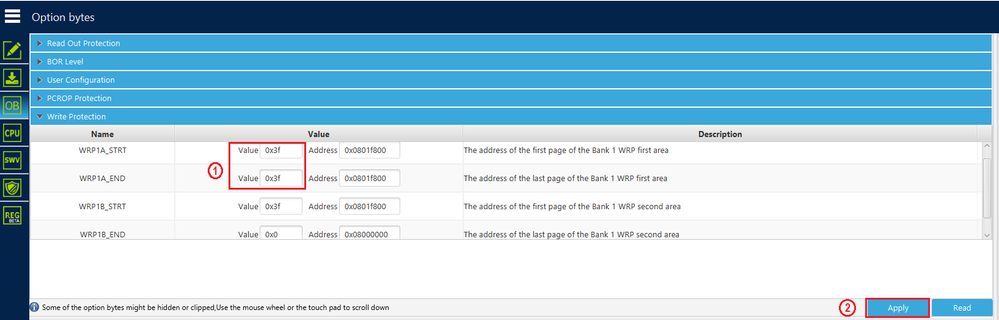

In order to protect page 63 using CubeProgrammer, you need to write the value "0x3F" in both WRP1A_STRT and WRP1A_END and finally click on Apply button.
_legacyfs_online_stmicro_images_0693W00000bhfS5QAI.pngWRP1A_STRT and WRP1A_END are respectively the addresses of the first page of the bank 1 WRP area and the last page of the bank1 WRP area. Since only 1 page needs protection in your case, the start and end addresses should be equal.
The value "0x3F" is calculated using the following formula which is mentioned in RM0394 section 3.5.3.
"The WRP “y�? area (y=A,B) is defined from the address: Flash memory Base address + [WRP1y_STRT x 0x800] (included) to the address: Flash memory Base address + [(WRP1y_END+1) x 0x800] (excluded)."
To remove the protection, the start address should be superior to the end address.
I hope this helps!
Sara.
