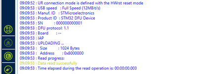

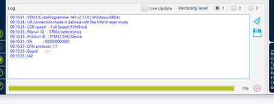

I've problems connecting via DFU. The cubeprogrammer is trying, but never reaches the connected state.
However, if I connect one time with a ST-Link device, the disconnect and switch to DFU then it works as long I do not close the CubeProgrammer instance.
Does anyone know why this is the case and what I can do to connect on the first try?
The first screenshot is when the conneciton does not work
Second is from a successfull connection
