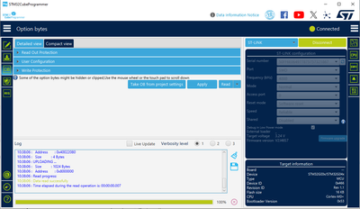

Hi @KDJEM.1 ,
With the Nucleo board I can see too, but for the project that I'm doing, I'm using a PCB that I made with the STM32G031F4P6, and I can't see the BOR configurations at the STM32CubeProgrammer, and I have the same version as you:
Because for my project I need some tension monitoring like the BOR. For the microcontroler that I'm using I saw in the datasheet and in the reference manual that I can use just the BOR or the PVD since the VREF+ is not available for this package (TSSOP20), and the BOR is the fonctionality that fits better for me.
Futhermore, I'm going to change the microcontroler for the STM32C011F6P6, wich has the same package but more memory. But I'm afraid that I'm going to have the same issue.
Do you know if I can solve this or if there is another fonctionality similar wih the BOR that I can use?

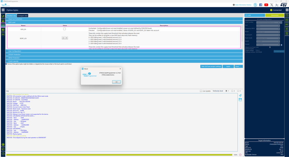

KDJEM.1
Hello @Fabiom02;
The issue is fixed in STM32CubeProgrammer 2.20.0 version.
I recommend you to try with the latest version and let me know if the issue is solved or not.
Thank you.
