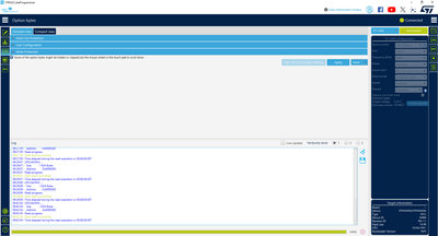

I am currently working with a custom PCB(Print Circuit Board) that features the STM32G031F4P6 microcontroller, and I am unable to locate the option to configure the Brown-Out Reset (BOR) in the Option Bytes within STM32CubeProgrammer for this device. Interestingly, I am able to see and configure the BOR on the Nucleo-G031K8 development board.
Could you please clarify if there is a specific reason for this discrepancy? Is there a way to enable or configure the BOR on the STM32G031F4P6 on my custom PCB? Additionally, are there any alternative methods to monitor the power supply or track the voltage levels of the STM32G031F4P6 microcontroller?

2025-07-08 6:07 AM
Hello @OUAHMANI ;
The issue is fixed in STM32CubeProgrammer 2.20.0 version.
I recommend you to try with the latest version and let me know if the issue is solved or not.
Thank you.
