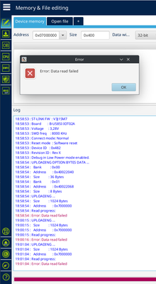

1. I have encountered a problem when trying to use B-U585I-IOT02A board with the default external loader available in stm32cubeprogrammer (M25LM51245G_STM32U585I-IOT02A). There is an error when trying to read, or write external flash memory, but erase seems to work fine. I am attaching the error screenshot.
From my program (FW - not external loader) external flash works well. What could I have done wrong? It seems very simple, however, it doesn't work as per the instructions and tutorials.

0x70000000 or 0x90000000, NOT 0x07000000

Thanks. I don't know how I could have missed it.
