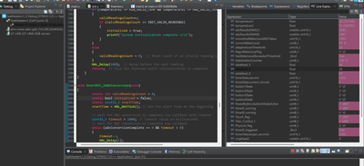

2025-07-08 8:58 AM
Dear PChat.4
I had faced similar things and now I can debug on X-ELITE note with ST-LINK/V2(NULCEO F446).
You can install ST-LINK device driver as WinUSB ( It is bundled in Windows11 ).
And you should set OpenOCD setting in CubeIDE debugger . ( It is bundled in CubeIDE ).
Current limitation: It cannot update firmware of ST-LINK/V2.
Please take look screenshots.
