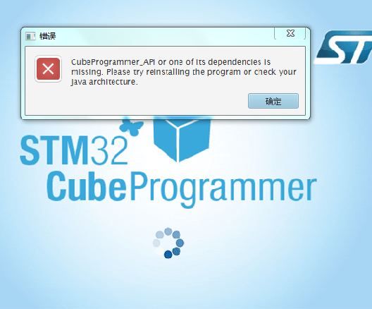

As shown in the figure. an error dialog box appears when starting the software

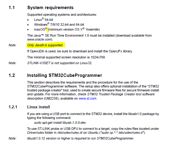

Hello @zhangtinglu
Could you please tell me which version of Cubeprogrammer do you use.
You should know that only Java8 is supported.
