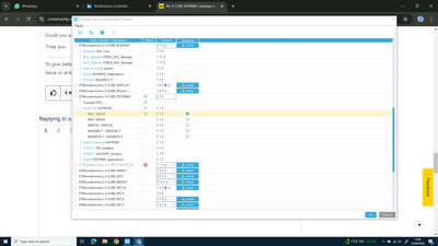

I am in work with a product firmware with STM32G030k8 with additional EEPROM M24C04 I coudlnt ble to instal the driver files .
Is this the righ tway am doing,can any one please address this?I am not able to hightlight or install Thanks.

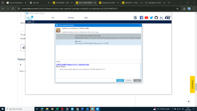

Your .ioc says 6.12version and Iam unable to migrate my cubemx version for updates
2024-09-25 4:38 AM
What CubeMx version you are using?
You cannot check the checkbox at the left in the CubeMx update window?
2024-09-25 4:44 AM
Yes I cant do that .
2024-09-25 4:46 AM
OK.
Could you please uninstall the old version (you didn't mention the version you have) and download/install the latest version: 6.12.1?

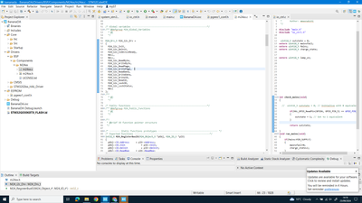

hi the .ioc file can work for me but when I am trying to use in my development environment I could'nt able to check/instal the driver package.

2024-09-25 6:18 AM
After cubenx update and a reboot I can able to do what I need. Verymuch thanks for you support
