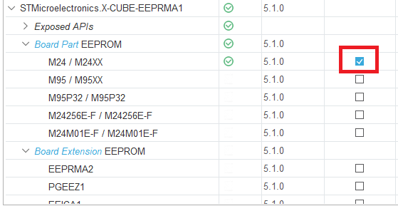

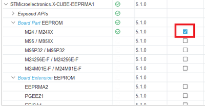

Hello @meena ,
You need to check one of the available drivers:
For example, for M24 / M24XX, check the box on the right and click OK.

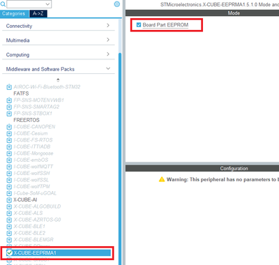

In "Middleware and Software Packs" menu , click on X-Cube-EEPRMA1 and check the box "Board Part EEPROM"

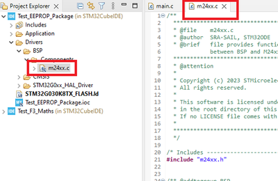

After generating the code, M24XX driver is included in the project.
Attached an example of ioc file.
Hope it helps.

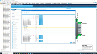

2024-09-25 3:41 AM
Hi Thanks yes but for some reason I am not able to tick (enable )the driver or install.May I know what is wrong

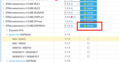

I am trying to install the drivers for M24 EEPROM chip which is interfaced with STM32G030k8 MCU.
As you said I have tried but my issue is I am not able to check that part or if i click install its nothing happening
2024-09-25 4:12 AM - edited 2024-09-25 4:18 AM
Do you mean you cannot check that blue box?
Or when you click on Install button nothing happens?
