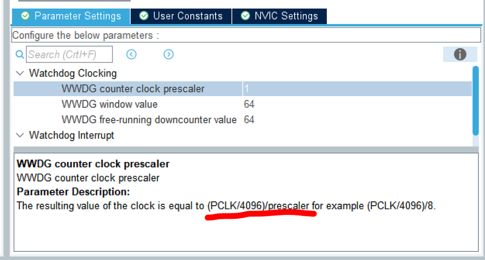

From L475 datasheet and reference manual it was mentioned that the WWDG clock source is from PCLK1. Whether PCLK1 Timer or Peripheral clock is used for WWDG? I couldn't find the details..
Attached reference image from cubeMX
Thanks

WWDG is in APB1 and is clocked from PCLK1.
