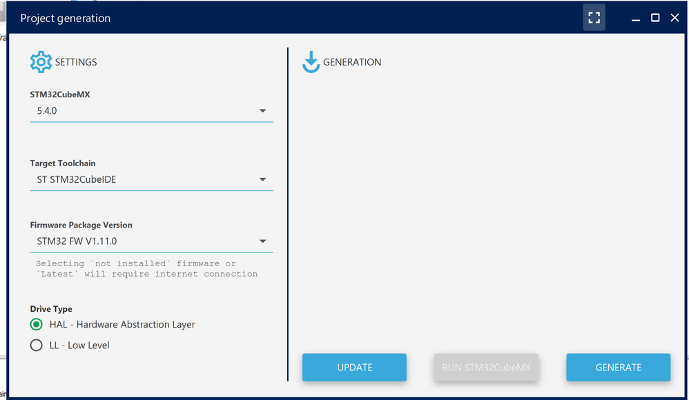

I finally got CubeMX to generate correct code for CubeIDE that builds without errors!
I noticed 'recommended' firmware package selected was an older one, so tried V1.11.0 as shown and voila !. The problems I was having prior to this was missing files, but this package seemed to resolve CubeIDE build issues.
Now, onward!!
2019-10-20 4:57 AM
Hello @DGome ,
I am glad CubeMX finally works for you. Just wondering, how do you get that screen? I don't have Project generation window in my STM32CubeMX v5.4
