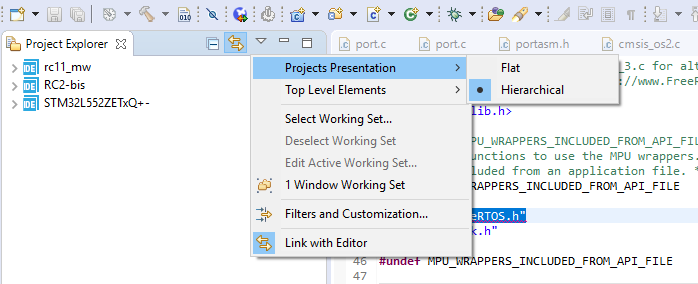

2019-10-07 1:54 AM
Hi @MShak
Try to check if Project Presentation is checked as Hierarchical.

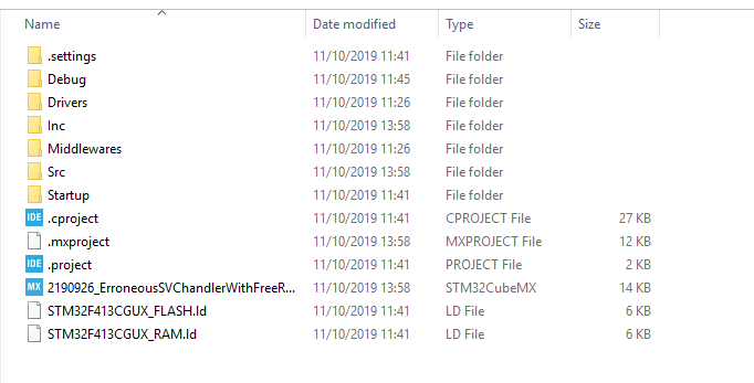

2019-10-11 1:14 PM
Hello @Nesrine.JLASSI ,
Thank you for your help!
Yes, it obviously works on your system, but this is what standalone STM32CubeMX generates for me:
I am using standalone STM32CubeMX v5.3.0, which version do you use?
