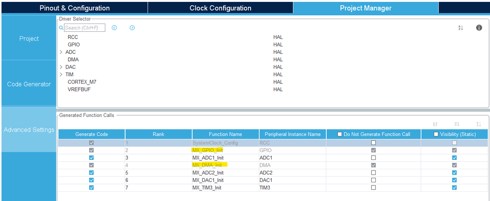

Hello NNar,
thank you for letting us know. We are aware of this issue and working on solution. Meanwhile you can solve this issue by disabling the functions calls of MX_GPIO_Init(); and MX_DMA_Init(); as in the screen capture below And the write this function calls USER CODE block SysInit:
