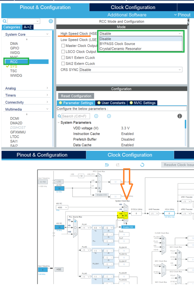

CubeMX ver. 5.3.0. I tried different microcontrollers.

Hello @VKole ,
First you need to enable RCC in HSE mode then you can use it under Clock config.
Best regeards,
