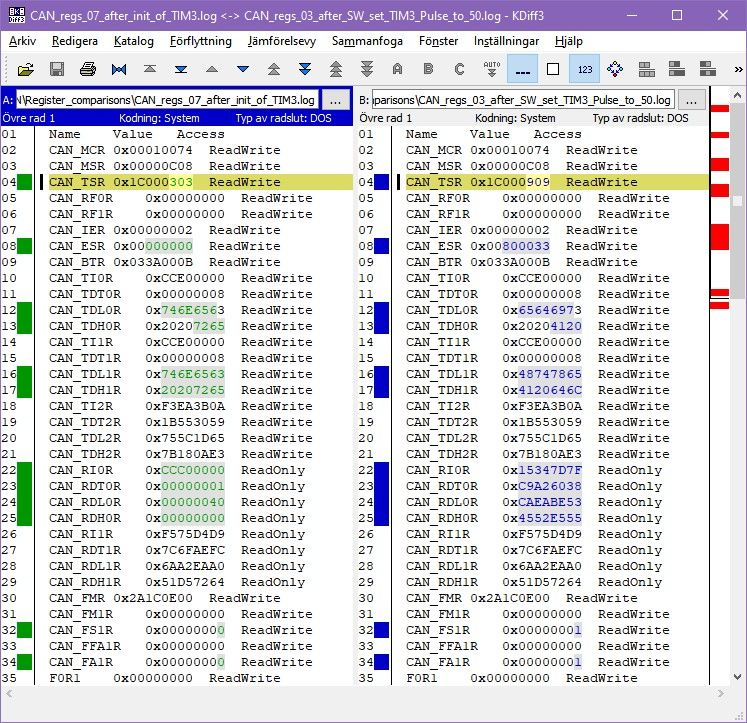

A straightforward approach is to compare the CAN and TIM register settings in the "working" and "not working" scenarios. Registers tell the whole story as far as hardware goes so no chance of missing something. There could still be bugs in your software which may not be reflected in register values.
2021-11-08 10:28 PM
Here is a copy of the CAN registers. To the left is what I get when I set Pulse = 50 for TIM3 in CubeMX. When I instead change that to 0 in CubeMX and set it to 50 by putting '__HAL_TIM_SET_COMPARE(&htim3, TIM_CHANNEL_1, 50);' in code, I get the scenario on the right, which is when CAN Rx is working.
