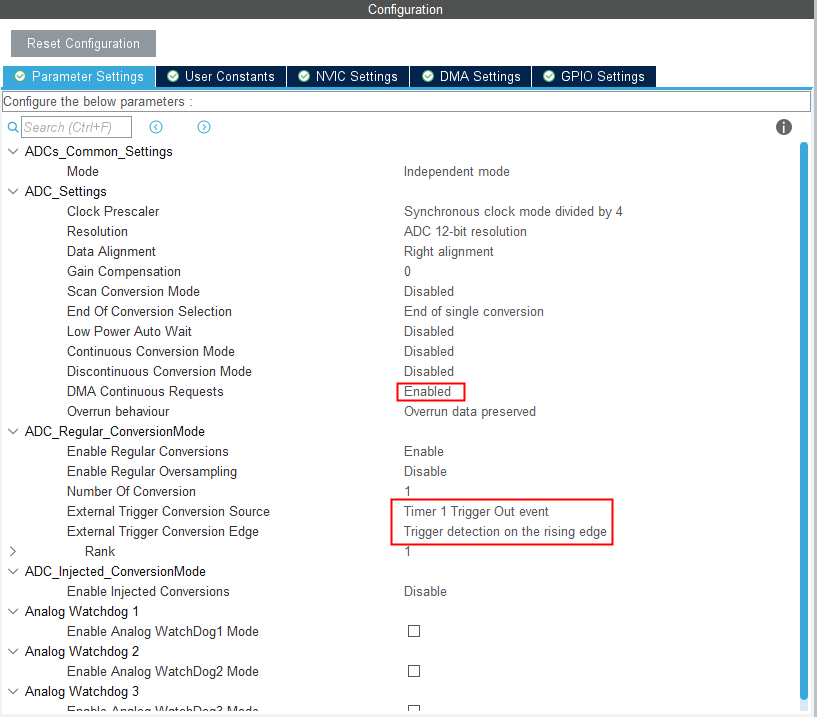

LL_ADC_REG_SetDMATransfer(ADC3,LL_ADC_REG_DMA_TRANSFER_UNLIMITED);
LL_ADC_REG_StartConversion(ADC3);

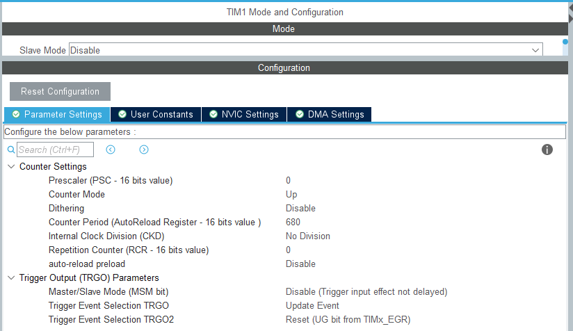

You should also set the interrupts you want before enabling the stream, to avoid calling them when you don't want to. Seems like you're using a timer to trigger the ADC here, so shouldn't be the case.
2023-11-28 10:22 PM
Yes,you are right.I used a timer to trigger the ADC.And in IRQ,check for HT being enabled & being set has been resolved this bug.
