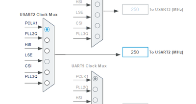

also I see the clock config for the UART2 and it's 250MHz from the PCLK1, should I change that?
