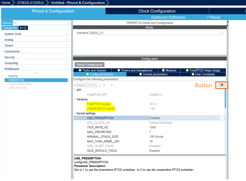

Hello @Scott Dev ,
To enable Freertos you should select one of the 2 version of CMSIS (CMSIS_V1 or CMSIS_V2) and depending on the availability.
Then, you can find under configuration-Config parameters versions of FreeRTOS and CMSIS and they depend on MCU and CubeMX version, also there is a button that can help you to use parameters .
