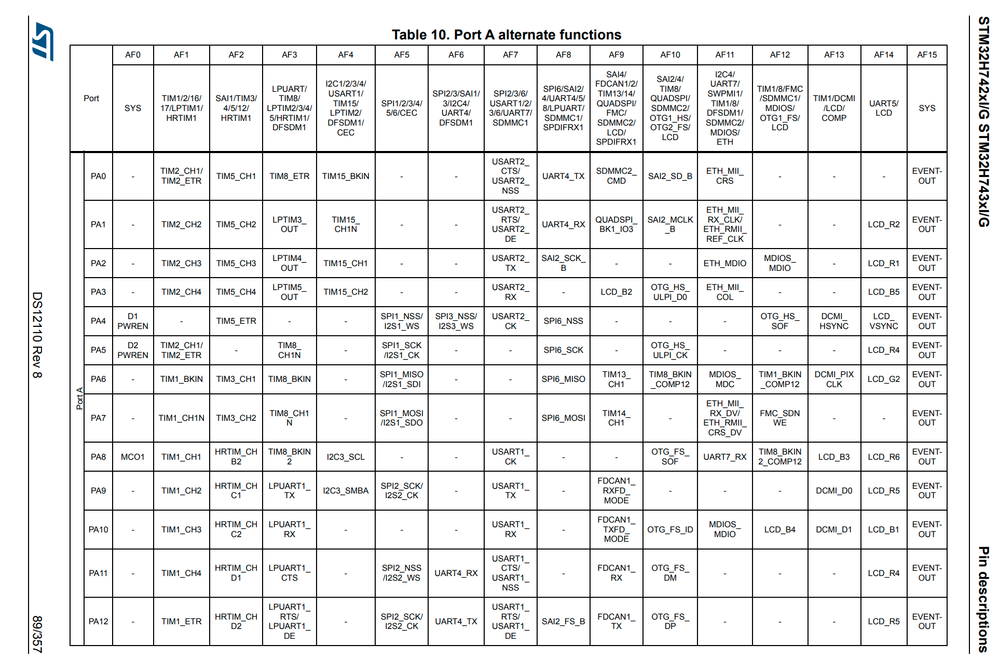

2021-12-05 6:28 AM
The datasheet has the mapping between pins and each AF mode.
If you want to use direct register access, also get familiar with the reference manual.
