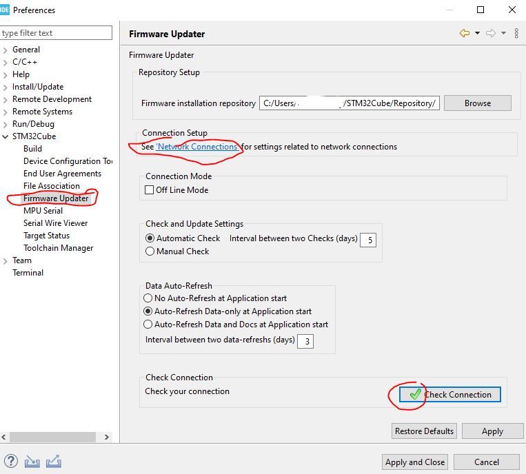

Definitively automated way of working is:
1) Rely first on FW setup settings/ Windows > Preferences > STM32Cube > Firmware Updater
Rely on Check connection button to verify your settings are fine: green check is required.
Note here you have some hyperlink to proxies setup & FW packages install repository setup.

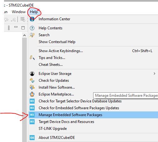

Then if not working (???) handmade install can be done for sure. Rely on www.st.com (or github) to get archive of such FW packages.
Still Help > Manage Embedded Software packages is right place for.

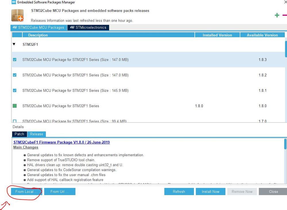

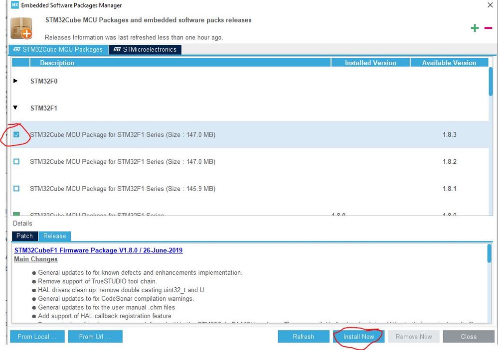

Being safe I would proceed here following 4 steps:
a) Remove any existing local trace of your F1 FW pack (see prevoius preferences sanpshot considerign FW packages install repository)
b) I would retrieve 2 archives. F1 1.8.0 master one then pacth 1.8.3 one
c) I would install first 1.8.0
d) Finally I would install 1.8.3
You have to be aware 1.8.3 archive is not self contain. Here you're only getting a patch to be applied on top of 1.8.0. (I full automated install process is working such is taking care for you about such dependencies hopefully)
