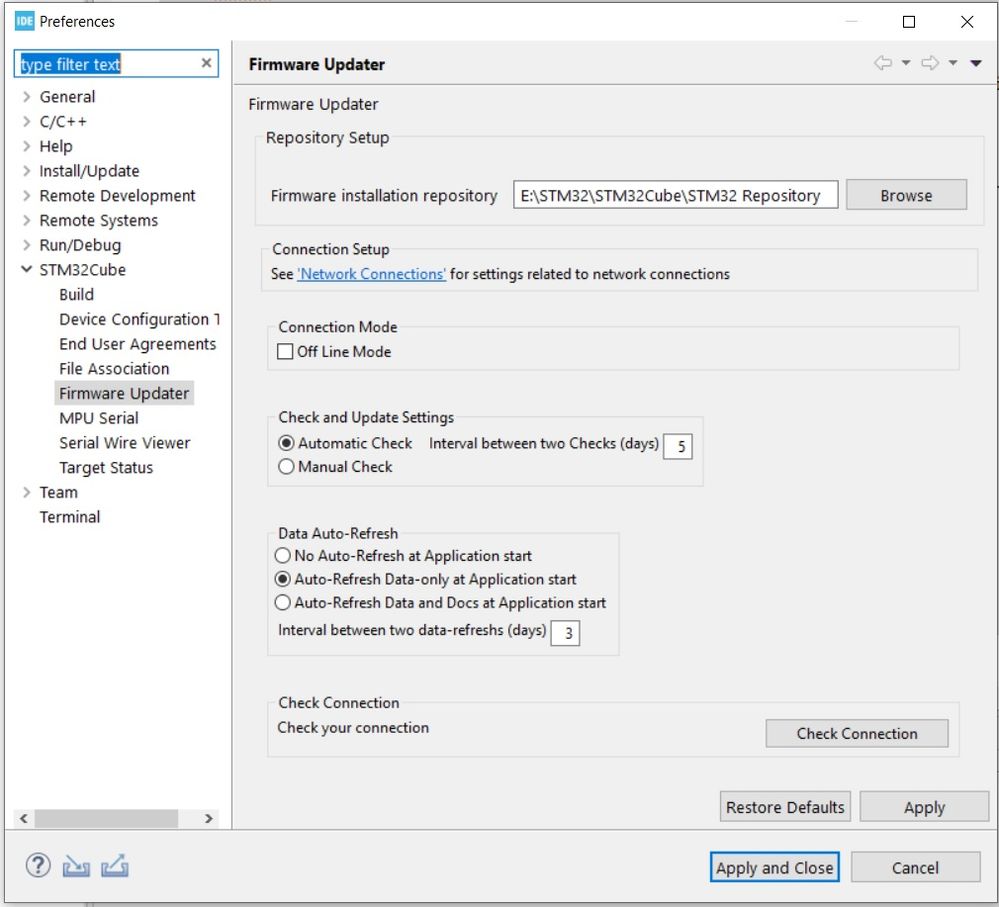

I've tried multiple versions and searched the form. After generating a .IOC i cannot generate code because cubeIDE cannot handle downloading and installing new firmware on its own. Why has this issue been known about for over a year and from what i see on the forum nothing has been done to correct it. I had this working previously with version 1.8.0 for STM32F10X. Because of the new update to 1.8.3 i cannot do anything! this is beyond frustrating since i migrated to the STM32 platform specifically for the improved toolchain. I am seriously considering switching to ARM and being done with this.
I have manually tried to install the 1.8.0 and 1.8.3 packages, by downloading them from the web and point cubeIDE to the zip and that fails too.
I even uninstalled cubeIDE because i was at version 1.3.0 and reinstalled to 1.4 and still nothing.
really considering dropping STM32 from current and future developments.

Which OS? Is your repository configured correctly? If yes go to Help->Manage Embedded Software Packages and download it.

If you're behind a proxy it doesn't work well, if at all. I have no problems downloading when not behind a proxy, except occasionally things seem to be down for a day per month. I had no issue updating (via Help -> Manage Embedded Software Packages) to 1.8.3 just now. You could always replace the HAL files manually if you're really desperate.

Win 10. through embeded software packages, i can see the list going up to 1.8.3. If I try to install 1.8.3 I get an error pictured above. I tried wiping out the repository and installing manually though the package manager and got the same thing. I was able to get 1.8.0 to actually show as installed so i selected to install .3 .2 and .1. only 1.8.2 installed correctly. So i have made a new project which is using 1.8.2 so i can continue my work.
