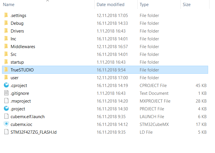

When "Generate Under Root" checkbox is set the code generator doesn't create the TrueSTUDIO folder.
When "Generate Under Root" checkbox is not set it creates a TrueSTUDIO folder and places the project files, the startup file and syscalls.c there.

I don't remember the scenario - I was busy with something else for a week or so.
CubeMX was 4.27.0 and Atollic was 9.1.0 (and they still are the used versions).
The TrueSTUDIO folder contains "startup_stm32f427xx.s" and folder "cubemx".
The cubemx folder contains folder ".settings" and files ".cproject", ".project", "cubemx.elf.launch" and "STM32F427ZG_FLASH.ld".
Sounds like some kind of backup, but could be something else too.

Yes, they look like backup - telling by the file dates.
