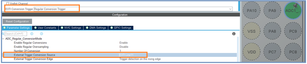

The ADC1_EXTI11 (which mean "extended interrupt/event controller") is a signal to Trigger the Regular Conversion for the ADC1, this signal will be automatically assigned to PA11 when it's selected through CubeMX as mentioned in the image below:
In fact, using this configuration will allow to run a conversion each time we have a signal in this pin ( Which can be trigged in the rising, falling or Rising/falling edge, depends on the configuration used). For more details about the maximum frequency that should be used in this pin, please refer to datasheet table ADC characteristics.

Thanks for the responses. Triggering the ADC is what I had missed in the docs.
