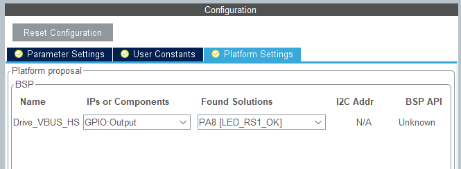

Please try to finish the configuration of USB_HOST : Platform Settings =>

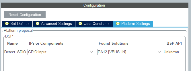

Also the configuration of FATFS : Platform Settings =>

2019-05-09 4:26 AM
Hi Nesrine, thank you, super! Because I don't use an SD Card detect switch, I didn't fill that one in. For the VBUS_HS, the proto-board was missing the track to the STM32H7. This solved the issue. And I found these Platform Settings TABs, after clicking FATFS and USB_HOST. Thank you very much! I assigned a few new pins for these (SD_DETECT input and USB_VBUS output).
