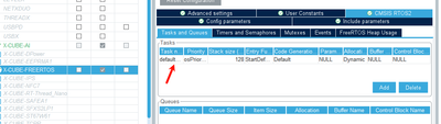

Additionally, I noticed that X-CUBE-FREERTOS is unable to retain newly created tasks. Even after saving the .ioc file, when I reopen it, all the newly added tasks are gone—only the default task that was originally present remains.

First Issue: Tasks,Queues,Timers,Semaphores,Mutexes are missing when reloading the ioc.
Internal Ticket Number ( Ticket 214187 )

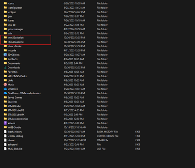

Hello @eric_green ,
For the second issue, I suggest that you delete the cache folders placed under: C:\Users\
I will be waiting for your feedback.
Thanks.
Mahmoud
Hi, @Mahmoud Ben Romdhane ,
It does not work.
THX.
