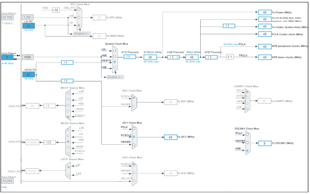

2. I think my clock configuration shown below meets the requirements since my APB clock is 48MHz and the FDCAN clock is 8MHz.

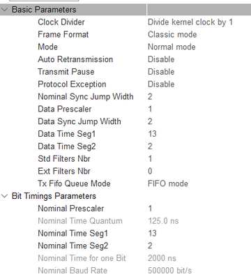

The FDCAN is configured as -
which are the same settings for Tq, Tseg1, Tseg2, etc as we have used in other designs, although they are based on F042 / F072 devices. This is the first design where I have used the C092.
I am testing it by trying to periodically transmit a message out to the CAN bus. By 'not working' I mean the message is not being sent. If I then change the clock settings to either use the HSI48 clock (and change the prescaler to 6 to keep Tq=125ns) or if I enable MCO2 sourced from from HSE or if I enable the RTC and use HSE as its clock source then the message is sent. This is reliable and works every time.
