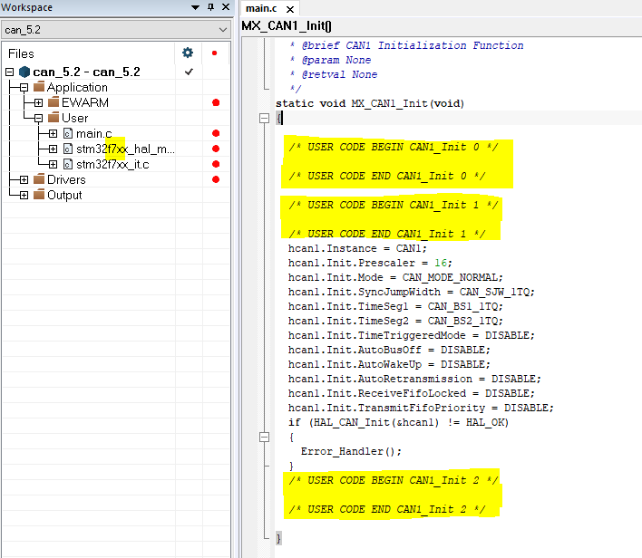

2019-06-04 2:12 AM
Using F7 with V1.15 firmware package version (I think this's your case) - there's no problem ! no difference between V1.14 and V1.15 concerning CAN User code section.
-CubeMX 5.2.1-
Best Regards,
Khouloud.
