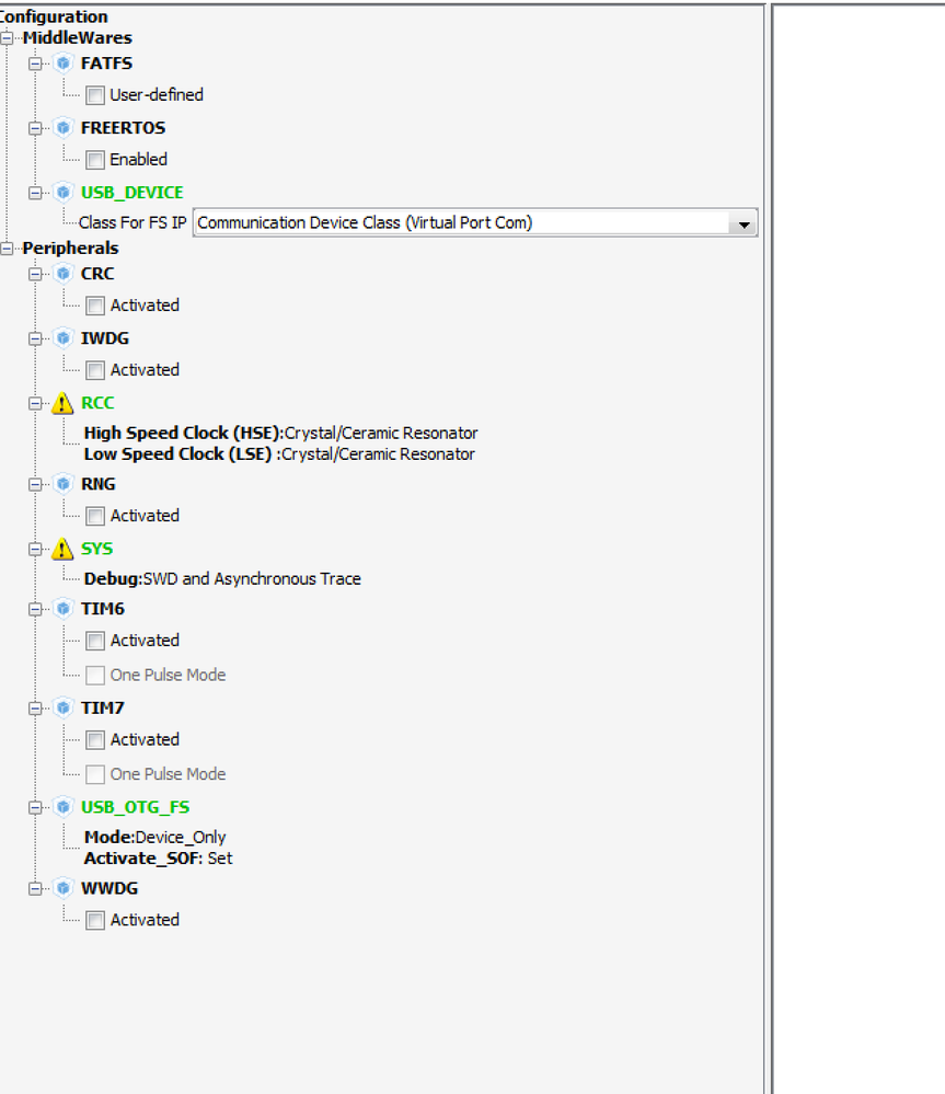

As a follow up, I also have just downloaded the latest version of MX (4.4.0) and uvision (5.12). Tried creating a cube project with USB_OTG_HS selected, using internal PHY device-only mode. Selected VBUS and SOF checkboxes. Exported the project, built with MDK and flashed the board. After plugging in the OTG port to my machine, I still cannot see any new devices show up.
2014-10-27 12:40 AM
Tried with FS mode too. Here is a shot of my latest attempted.
