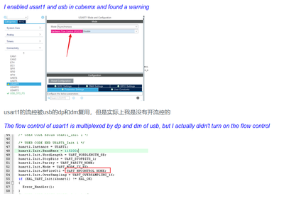

我在cubemx中同时使能usart1和usb发现有个警告
I enabled usart1 and usb in cubemx and found a warning

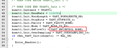

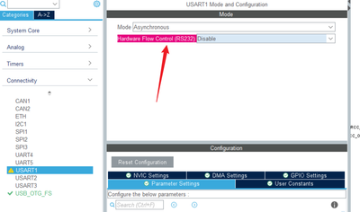

usart1的流控被usb的dp和dm复用,但是实际上我是没有开流控的
The flow control of usart1 is multiplexed by dp and dm of usb, but I actually didn't turn on the flow control
为什么同时使用usb虚拟串口和usart1收发数据的时候,发现只要usart1一发送数据,两个串口都没有输出了??
这是为什么呢
Why when using the USB virtual serial port and usart1 to send and receive data at the same time, I find that as soon as usart1 sends data, both serial ports have no output? ?
Why is this?

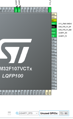

Now regarding your original question, as I said it's a conflict with USB pins:
Doing the exercise, unfortunately there is no available CTS/RTS pins for USART1:
The only available pins are used by the USB.
For the USB question please open a new thread. This one will be closed.

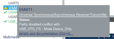

Second, mostly because there is a conflict in the pin usage especially with CTS/RTS pins that are used with USB pins. You need to pass you mouse cursor over "USART1" and you will get the warning that provides you the information about the conflict.
You can still use UART1 without HW control with USB or find another GPIOs containing these alternate functions of CTS/RTS.
