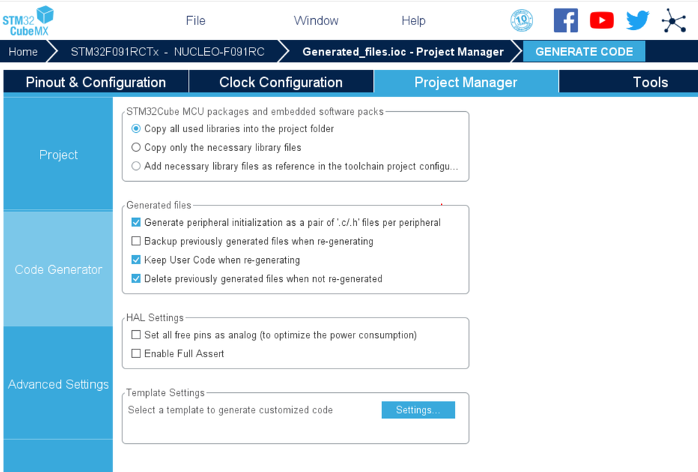

2021-01-11 3:03 AM
Hello FLamb.2,
STM32CubeMX tool offers you the possibility to whether generate the peripheral initialization in separate .c/.h files or keep all peripheral initialization in the main.c file. In fact you can check "Generate peripheral initialization as a pair of .c/.h files per peripheral" option under Project Manager/Advanced Settings panel as showed in the attached screenshot.
Hope this answers your question.

2021-01-11 3:03 AM
Hello FLamb.2,
