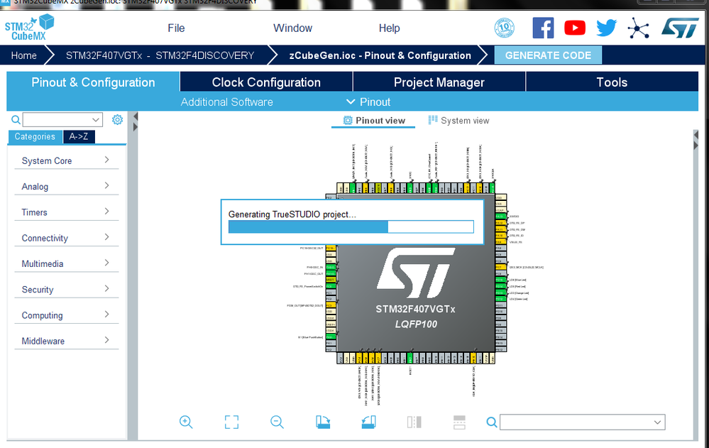

I'm trying to generate the code on the STM32F407G-DISC1 evaluation board for the TrueStudio project environment.
The code generation just freezes.
Has anyone else seen this?
I'm running on Windows 7 Pro, 64 bit
I've tried different combinations of projects and processors but the result is the same.

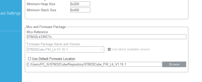

2020-04-09 7:05 AM
Hello, I looked the path, i don't have any special caracters. My path is like that:
2020-04-09 8:16 AM
Hello, I resolved the issue. My work folder contained effectively a special character. I changed the work folder's name and all is OK. Thank you for your suggestion. :ok_hand:
