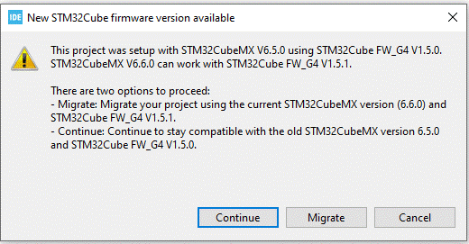

I just went to recompile my project after a couple of days of no changes - I got this dialog...
I hit migrate and the process completed with no error messages that I could see.

2022-07-08 1:03 PM
Bug in the migration, most likely. They already released a patch, 6.6.1
2022-07-11 5:04 AM
Yes, I see there is a 6.6.1 version now. However, when Migrating the project from 6.6.0 to 6.6.1, even this one erased all my source files and just created the CubeMX ones. So the bug is still there.
The only way to proceed is to do the migration and then copy all the missing files back.
