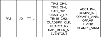

The datasheet has OPAMP1_VINM / OPAMP1_VINP / OPAMP5_VINM.
How do these each of these three items map to the entries in the list below?

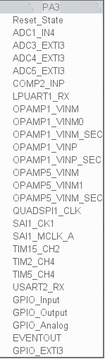

Sorry the picture didn't come through. Weird - it was in the version I composed. Trying again.
I left click on ball PA3 and this menu pops up (see STM32CubeMX).
Since I'm working with opamp1, what do the following mean:
OPAM1_VINM
OPAM1_VINM0
OPAM1_VINM_SEC
OPAM1_VINP
OPAM1_VINP_SEC
STM32CubeMX:
Datasheet - DS12288 Rev 4, page 61:

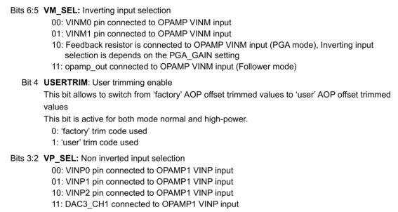

Reference manual - RM0440 Rev 4, page 800:

2020-11-07 7:36 PM
A suggestion for the CubeMX team - please make all pin configuration available. For example, in the bit definition for VP_SEL, I can select three inputs VINP0, VINP1 and VINP2 in the registers but CubeMX doesn't let me setup pins for these. I can setup the primary pin and then have to make the pin an GPIO_Analog which is confusing because it would be nice to know which pin i've mapped to which opamp/mux input in CubeMX.
