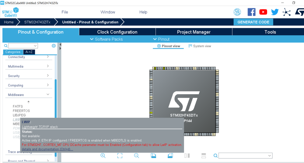

I'm currently using STM32CubeMX for STM32H743ZITx.
However, I can't enable LWIP function. (Categories -> Middleware -> LWIP)
Previously on STM32F429, I could use LWIP, but I can't even enable the function on this series.
Can anybody help me with this?
Thank you in advance.

Hello @SHong.5 ,
For H7 series , in addition to ETH , you need to Enable the CPU DCache under system core - Cortex_M7 (for your case) so that LWIP becomes available be enabled.
Best Regards,
Khouloud

2020-11-05 11:24 PM
Hello Khouloud
Thank you very much. I have solved LWIP issue from above solution.
