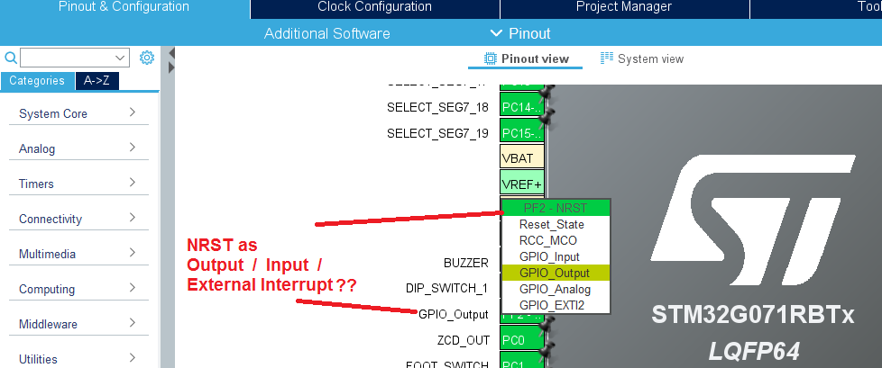

I am working on STM32G0 Nucleo Board with STM32 Cube IDE 1.3.0
How to configure STM32G071R8 64-Pin LQFP Package
as Input or Output or Interrupt with STM32 Cube IDE 1.3.0 . ?
Is there any special setting ? Which I am missing ?
Karan
2020-07-11 7:50 AM
Change the NRST_MODE option bits to 0b10 using STM32CubeProgrammer to disconnect that pin from internal NRST. See info in the reference manual.

2020-07-11 7:58 AM
Thanks..Solved..
