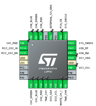

This is my pinout:

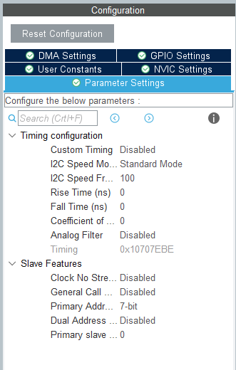

My I2C config:

Debug the hard fault, see why it was triggered and from where and go from there.
You can examine the extremely simple code for __HAL_I2C_GET_FLAG and verify it should not cause hard faults under normal circumstances. Verify that the handle you're passing to the function is valid and has not been mangled.
The I2C peripherals are independent. Using them both will not cause hard faults, the answer is elsewhere. Could be a buffer out of bounds write, stack overflow or something else.
