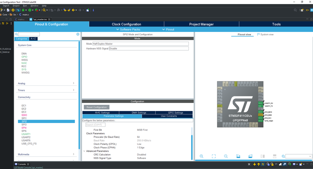

I am trying to get 2 stm32f411's to communicate via SPI. From my understanding, there should be 1 master device while the others should be its slaves.
For my master device, I am using full-duplex master and I have disabled NSS and enabled the NSS pin as an GPIO OUTPUT pin.

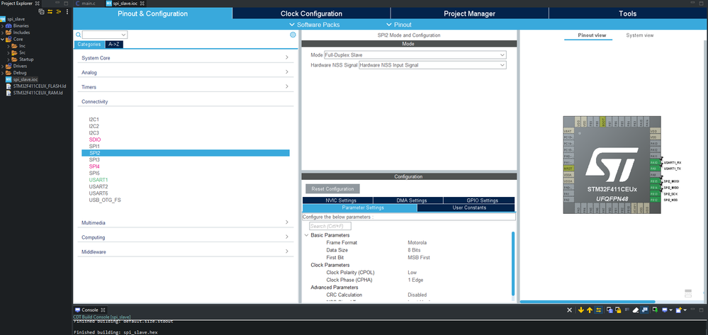

For my slave device, I am using full-duplex slave and have enabled NSS INPUT SIGNAL so it knows when it needs to read.

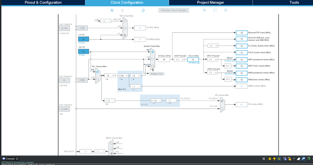

Here is a screenshot of the clock configuration I am talking about.

the slave gets its clock from the master, you don't setup a slave clock.
