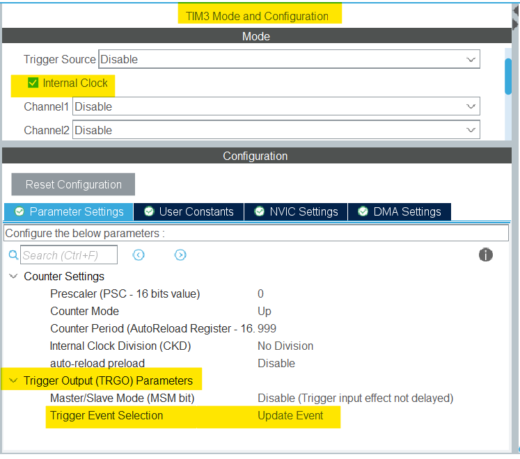

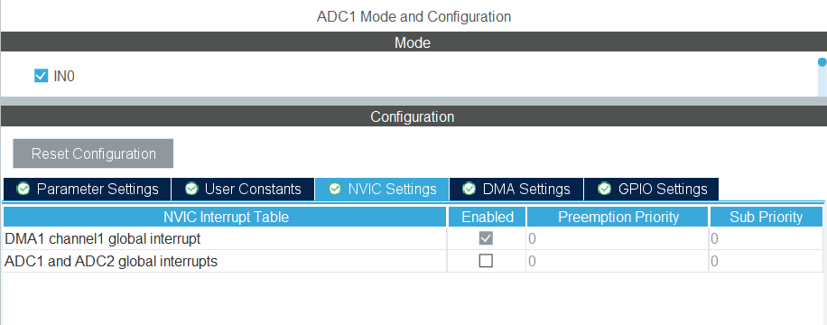

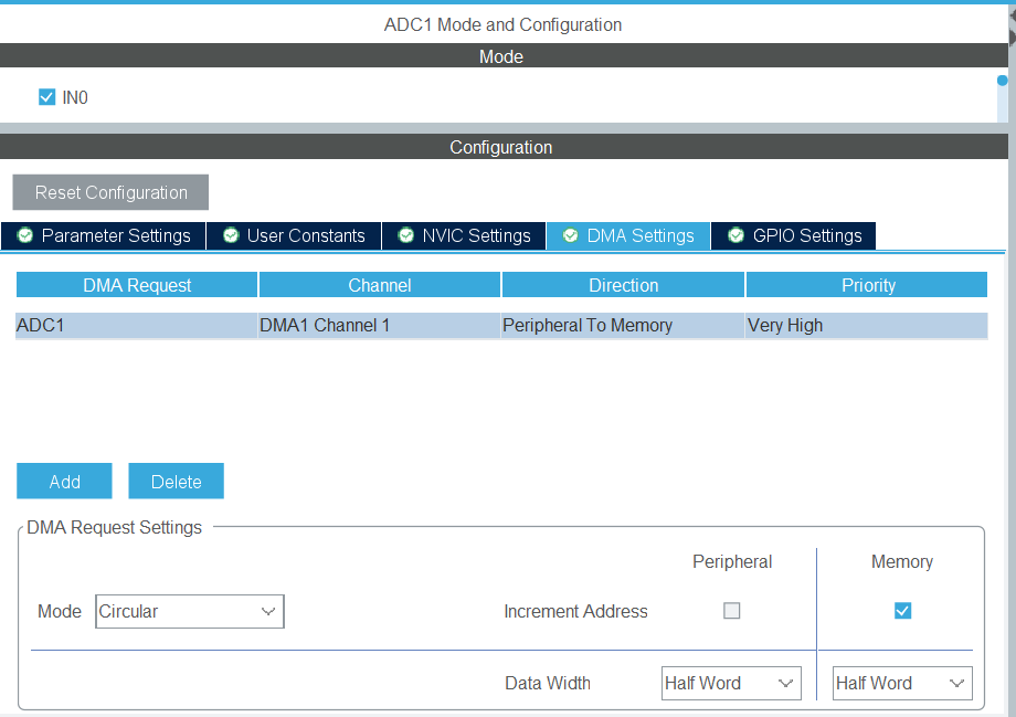

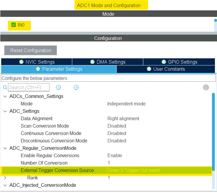

In the TIM3 Mode and Configurations, in the tab Parameters Setting, in the field Trigger Output (TRGO) Paramters, i´ve set Trigger Event Selection like Update Event. These settings are shown in the figure below.No modo e configuração ADC1 fiz a seguinte configuração.
