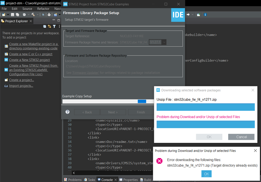

Hello, when I tried to create an stm32 project, at the last step of generating the code, I came across this warning and the code was not generated.
After it tried to unzip stm32cube package, it says "Target directory already exists". I did already download and unzip the package. But it seems not using that folder and files. Do I have to remove the one I unzipped and then creating the project?

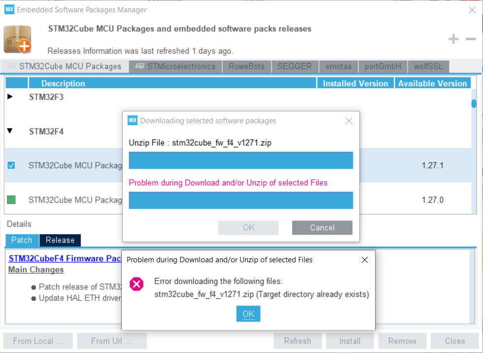

This is the screenshot when trying to install the package.

Hi @Crane,
In the screenshot you attached, the package installed is the STM32F4_Cube_FW V1.27.0 not the V1.27.1 required.
Thank you.
Chahinez.

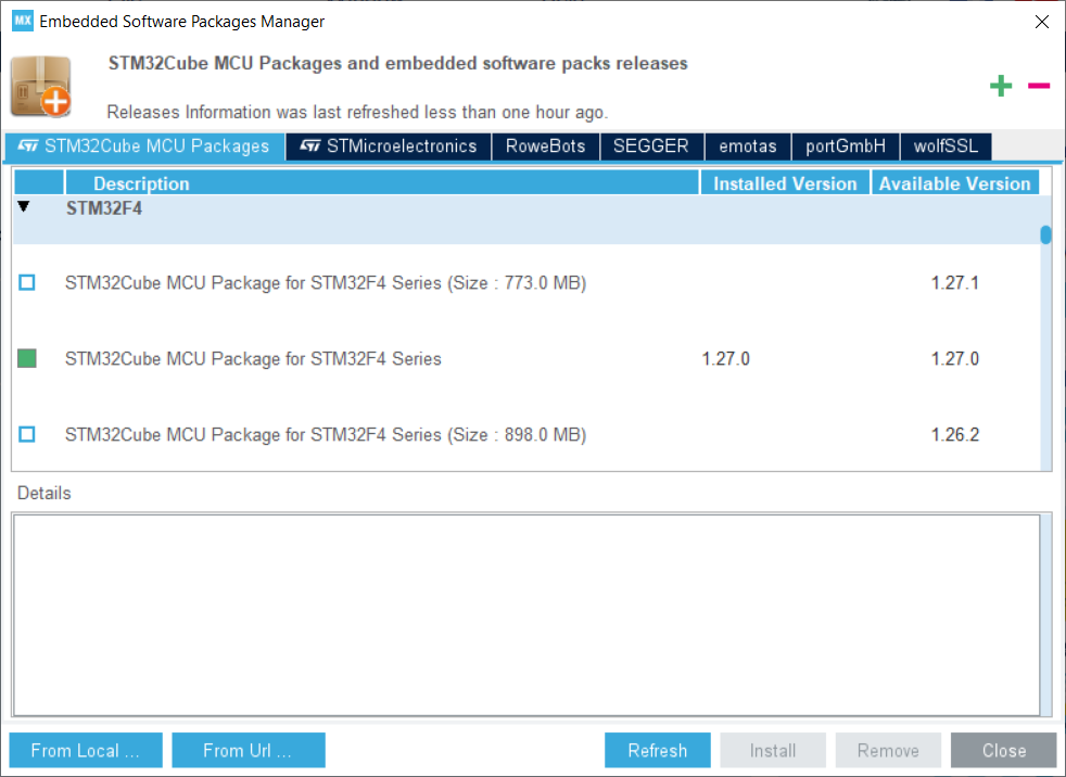

2022-09-15 6:56 PM
I tried to install the latest version, but got the same warning. I already moved the current version to another folder.I am wondering why it must require the latest version. And the latest version is only a patch to the last version.
