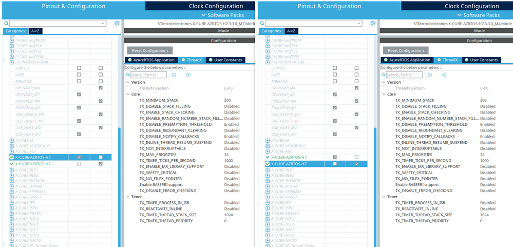

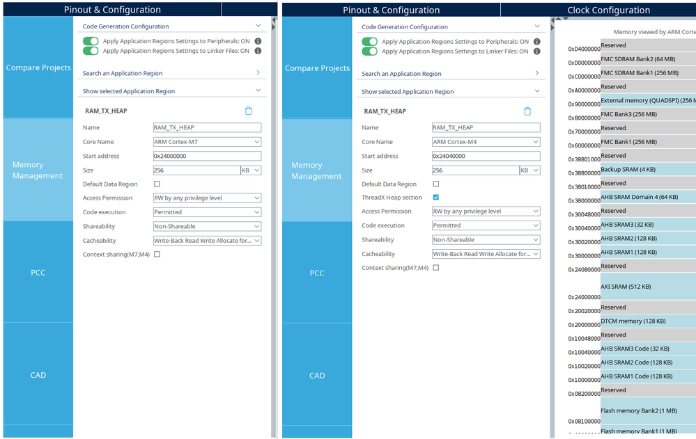

We are setting up ThreadX on the STM32H747I-DISCO and have enabled the Memory Management section in CubeMX to generate linker scripts. There is an option to automatically insert the ThreadX Heap memory section on the CM4 core, but not the CM7:
threadx options
The options within the ThreadX Middleware are the same:
threadx middleware options
Is there some other option that we should be using to automatically generate the ThreadX memory section?

Hello @chipchop
After checking, I was able to see the ThreadX heap section with CM7 when I set ThreadX for CM7 only.
But you have right when enabling threadX in two contexts, CM4 and CM7, it is only available on CM4.
An internal ticket 206740 has been submitted to the dedicated team and I will keep you informed about any updates.
