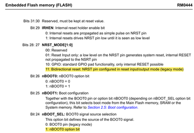

TDK
Super User
The PF2-NRST pad is tied to both PF2 and NRST internally. Always. Similar for PA14-BOOT0. You can change how NRST and BOOT0 behave through the option bytes via STM32CubeProgrammer. Default values are highlighted here.
Note that since nBOOT_SEL=1 by default, the value on the BOOT0 pin is ignored in favor of the nBOOT0 option bit.
