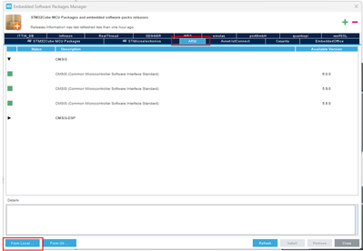

Hello @CTapp.1
The CMSIS pack V6.1.0 can be downloaded from arm website and then imported locally in CubeMX( Help> Manage embedded software package), as shown in screenshot:
BR,
Souhaib

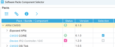

I then used the Software Packs Component Selector to add in CMSIS CORE:
And then enabled it in the Middleware and Software Packs:

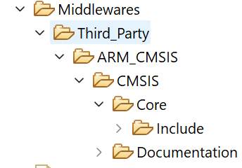

But, when I save the .ioc and the code is regenerated, that just gives me a second set of CMSIS files:
How do I replace the set under Drivers/CMSIS/Include instead?
