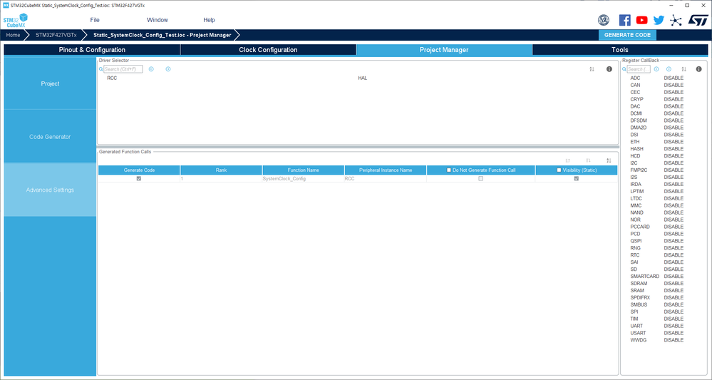

HI,
I set up STM32CubeMX to declare SystemClock_Config as static.
However, SystemClock_Config is not declared static.
The versions in question were STM32CubeMX 6.3 & STM32Cube FW_F4 V1.26.1.
I also tried the latest version of STM32CubeMX 6.5 & STM32Cube FW_F4 V1.27.0, but it didn't solve the problem.
Is there any documentation on this issue?

Hello @Mkim.4,
It seems that there's a code generation problem in CubeMX tool. The issue have been reported to CubeMX development team.
Internal ticket number: 126522 (This is an internal tracking number and is not accessible or usable by customers).
